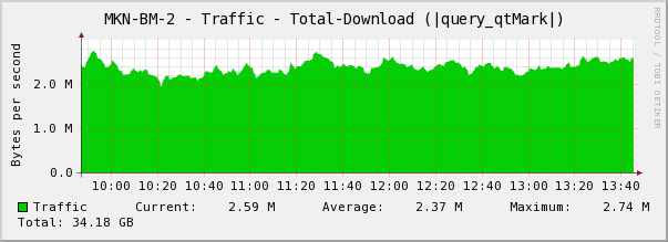

Simple Network Management Protocol (SNMP) is an Internet-standard protocol used to monitor and manage devices on IP networks. It can be used with monitoring tools such as Cacti, MRTG, or The Dude to collect, visualize, and graph system data.
